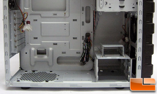

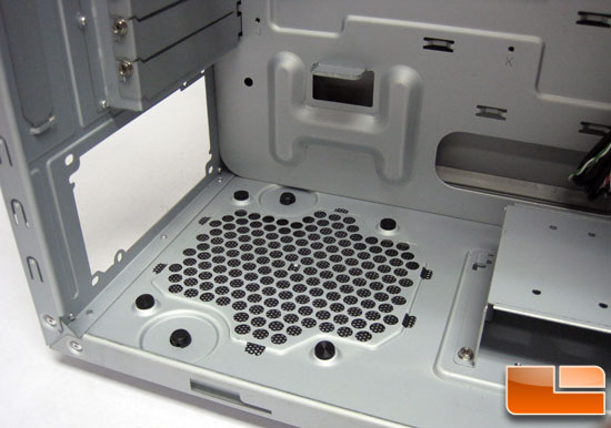

The bottom mounted PSU has rubber vibration isolators and a vent. The vent has a dust filter that can be removed from the outside for cleaning.

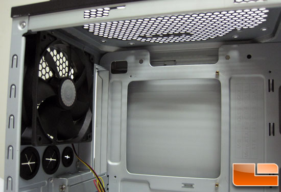

In the top rear we can see the 120mm rear exhaust fan and top vent. The fan has a standard 3 pin fan connector, but also includes a 4 pin molex to 3 pin fan adaptor if you want to power the fan from the PSU and not the motherboard fan header.

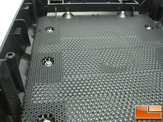

Looking at the inside of the bezel we see that the whole thing is covered with a dust filter.

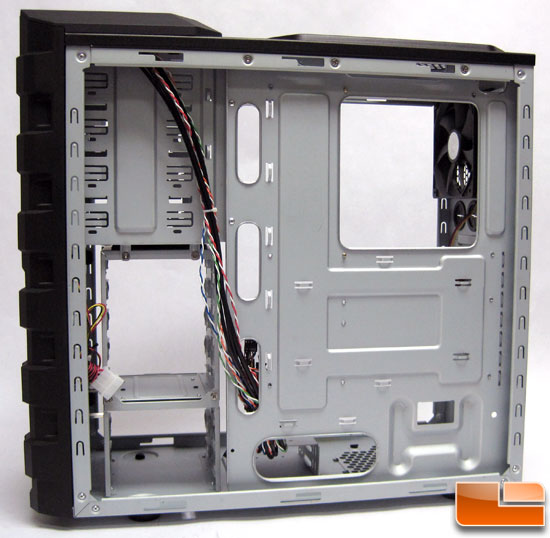

Pulling the right side panel off we can get a look at the motherboard tray. The tray has a very large CPU cutout and wire management holes for routing cables. Cooler Master spaced in the motherboard panel 16mm, which is enough space to route and hide most of the cables you don't want your friends to see. The hard drive cages also have holes for routing cables; there are three round rubber grommets in the rear of the CM HAF 912 for water cooling lines and, of course, it has the usual tabs sticking out for cable ties for those that want to zip everything up to the tray.
