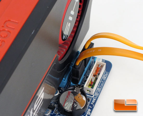

GIGABYTE 880GMA-UD2H SATA Clearance
As you can see in the above image, when using longer cards like the ATI Radeon HD 5870 there is a clearance issue. Three of the five SATA3 ports are blocked by my HIS Radeon HD 5870. Now, there are shorter performance cards out there so if you were to use something like NVIDIA's GeForce GTX 460 or an ATI Radeon HD 5770 there will be no issues with clearance with those graphics cards. That is an option that you are going to have to weigh; it's going to depend on what type of configuration you are going to use. If you plan on only running two drives the GIGABYTE 880GMA-UD2H will suit you perfectly. If you plan on needing more drives you will have to evaluate your options for graphics cards. I would have liked to have seen the SATA3 ports parallel to the board because that would have eliminated this issue. Otherwise, the GIGABYTE 880GMA-UD2H is a great board.
