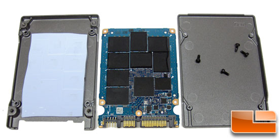

Since we have never seen what components are being used inside the second generation Kingston SSDNow V+ series we opened up our 128GB drive to see what the internals look like.
After removing the four 1.5mm Allen head screws that hold down the
Kingston SSDNow V+ Series cover we were able to lift off the cover and
see what makes this little SSD tick. With the cover removed we see a
total of eight Toshiba MLC NAND Flash memory chips, a Toshiba controller and a Micron DRAM IC that serves as a cache chip. One very interesting thing was noticed once we opened up the SSD, and that is the fact that a thermal pad is placed between the metal casing and the components on the PCB. This helps transfer the heat away from the components, which helps keep them cool and the large metal casing acts like a heat spreader. This is something that we haven't seen before and is very interesting.

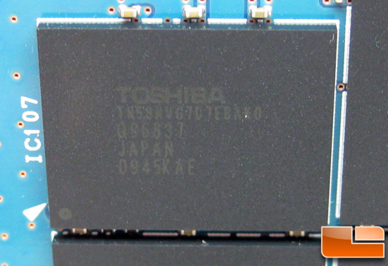

Here is a closer look component side of the PCB where you can make out the eight TH58NVG7D7EBAK0 MLC NAND Flash memory chips that are being used on the drive. This drive with these chips is pretty much bullet proof as it has an operating vibrating tolerance of 2.7G! The non-operating vibration tolerance is 20G, which is amazing when you think about how much force that would be.

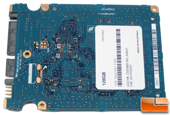

Flipping the PCB over we can take a look at the other side, which is bare and has just the sticker on it from Toshiba. This sticker also states what firmware comes with the drive and in our case it was firmware version AGYA0201.

The eight Toshiba TH58NVG7D7EBAK0 MLC NAND Flash modules are used on this drive, which are newer multi-layer cell chips from Toshiba.
