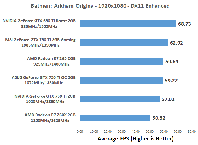

batman-fps
Benchmark Results: Right off the bat we can see the NVIDIA GeForce GTX 750 Ti easily beats the AMD Radeon R7 260X when it comes to performance. The factory overclocked GeForce GTX 750 Ti cards by ASUS and MSI perform better than the reference card and the MSI GeForce GTX 750 Ti 2GB gaming card was able to outperform the AMD Radeon R7 265 2GB video card in Batman: Arkham Origins! We were shocked to see that there was such a big performance difference between the MSI GeForce GTX 750 Ti and ASUS GeForce GTX 750 Ti as there is just a 13MHz clock difference on paper between the cards core and boost clock speeds.

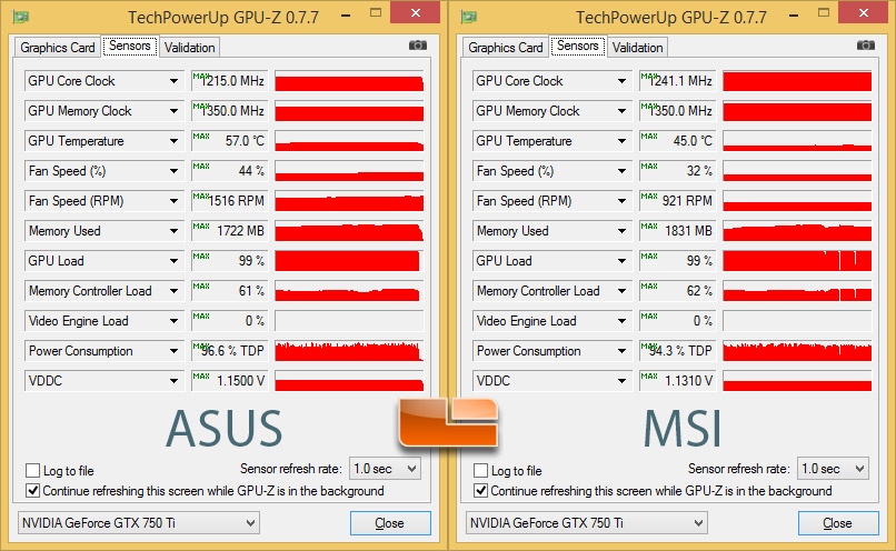

different-boost-clocksWe dug a little deeper and found that when gaming the ASUS card was actually running at 1215MHz with the GPU reaching 57C and the MSI card was running at 1241MHz and was at just 45C. It looks like that better GPU cooler was able to reward MSI with an additional 13MHz of overhead due to the lower voltages and temperatures on the GM107 GPU.

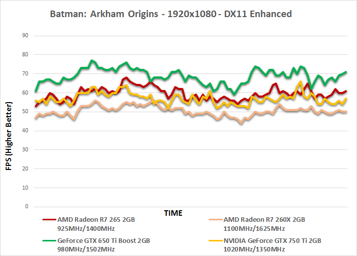

batman-time
Benchmark Results: We won’t be showing the AIB cards performance over time, but you can check out the reference cards in the chart above. The AMD Radeon R7 265 2GB and NVIDIA GeForce GTX 750 Ti 2GB reference cards are pretty similar.
