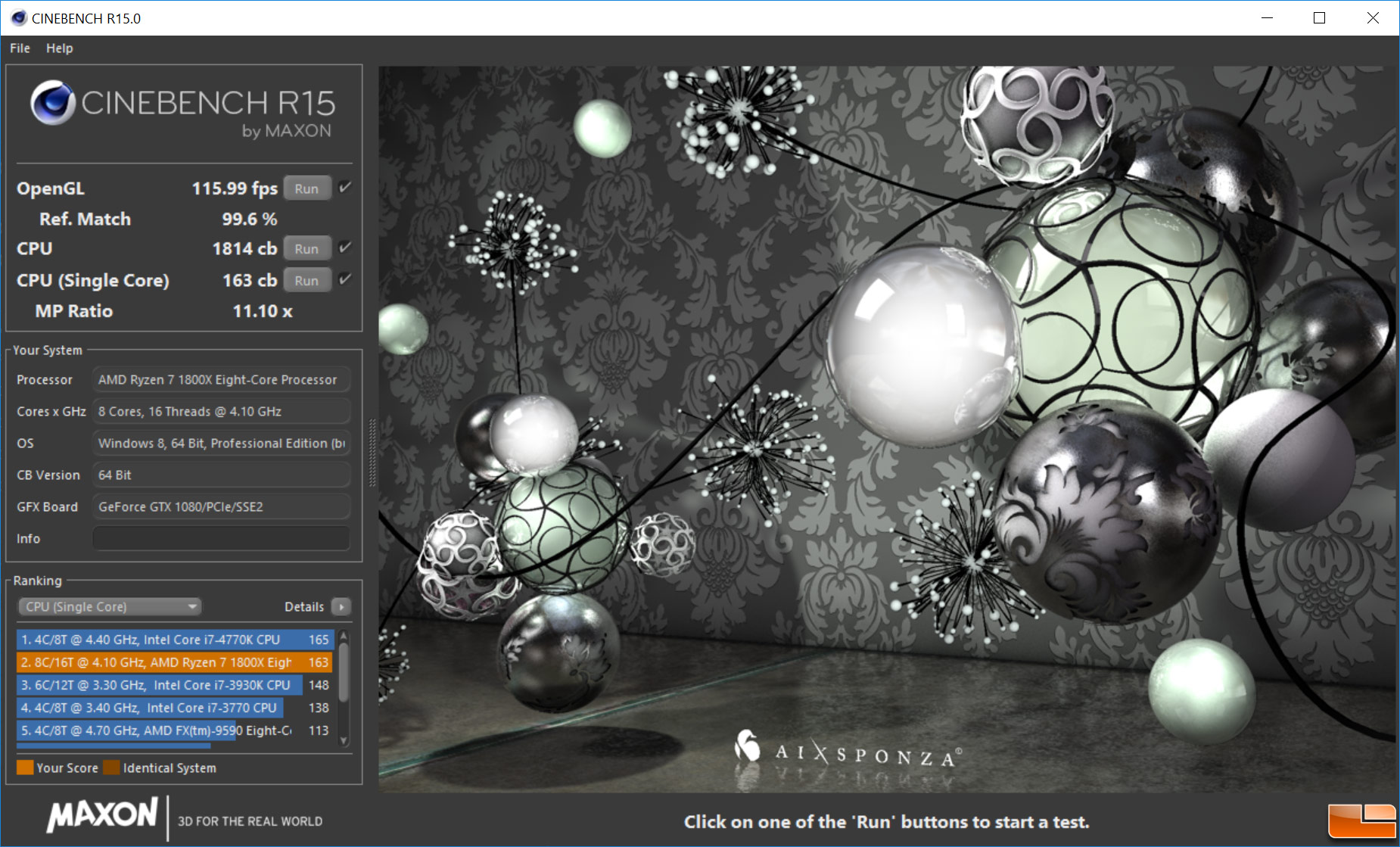

By increasing the CPU voltage up to 1.46V from the ‘auto’ setting on our board of 1.34V we managed to get up to 4.1GHz on all cores.
This took our multi-threaded CPU up to 1814 points and took our single-threaded performance right back to where we were straight out of the box since 4.1 GHz is the top clock speed by default with Turbo Boost and XFR. Running 4.2GHz was possible on our system, but it wasn’t stable in long video encoding benchmarks and we were up to 1.5V and stopped increasing the voltage at that point.
