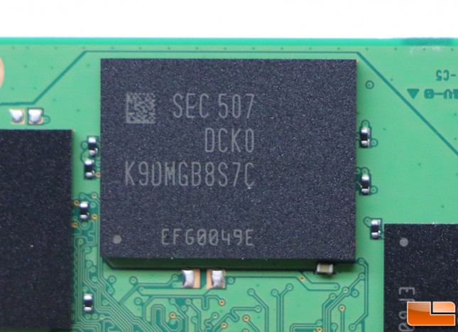

The Samsung SSD 850 EVO uses Samsung 3D V-NAND flash memory with a product number showing K9DMGB8S7C.
