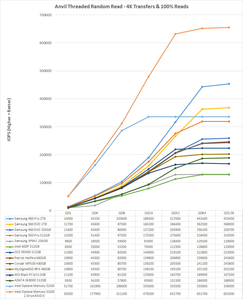

Benchmark Results: We used Anvil to check the 4K Random Read performance and found we we topped out at 336,000 IOPS on the 32GB drive and 655,500 IOPS on two 32GB Intel Optane Memory drives in RAID 0, which is far and away the highest on our chart although it is the only RAID 0 result on the chart. The QD1 thru QD8 4K Random Read performance was simply mind blowing with 51,700 IOPS at QD1 and then 161,900 IOPS at QD4 and 286,000 IOPS at QD8 on a single Intel Optane Memory 32GB gum stick. Compared to the Intel SSD 600P PCIe NVMe 512GB SSD that is 6x more 4K Random Read IOPS at QD1, 5x more 4K Random Read IOPS at QD4 and 5x more 4K Random Read IOPS at QD8! Hopefully this is a sign that the upcoming Intel Optane Memory SSDs will have killer low queue depth performance!

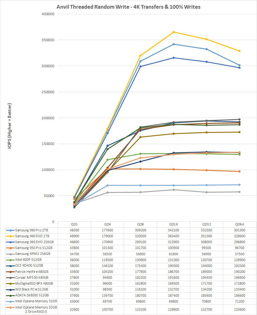

Benchmark Results: When it came to 4K Random Write performance, the Intel Optane 32GB drive topped out at 71,200 IOPS at QD32 and then in RAID 0 we managed to his 133,600 at the same queue depth. 4K Random Write performance isn’t the strength of this drive as it was designed to be a caching module and not a primary storage drive.
