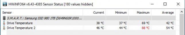

Using the S.M.A.R.T. temperature sensor we found the Samsung SSD 980 1TB drive had a minimum temperature 0f 37C, a maximum temperature of 69C and an average of 42C inside our test system. Those readings were for the first sensor. The second sensor has a minimum temperature of 44C, an average temperature of 54C and a maximum temperature of 88C.
The warning temperature threshold on this drive is 82C and the critical temperature threshold is 85C. Our temperatures never crossed these thresholds, so ‘Drive Temperature’ must be what Samsung is using to determine when the drive overheats.
