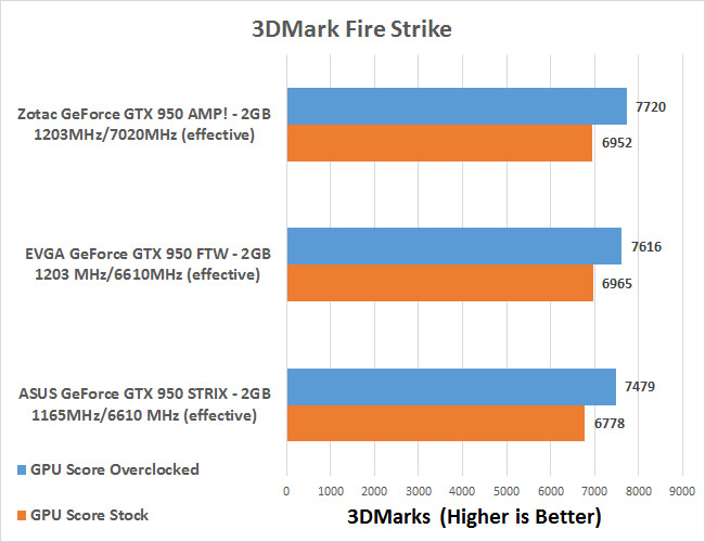

On synthetic benchmarks like 3DMark Fire Strike the GPU test score showed some nice gains were to be had from overclocking.
