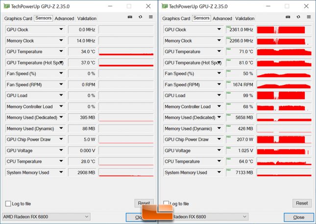

AMD Radeon RX 6800 Temperatures:
AMD Radeon RX 6800 XT Temperatures:
We tested the cards with their default settings and found the AMD Radeon RX 6800 had an idle temperature of 34C (37C hotspot) and the Radeon RX 6800 XT was at 32C (35C hotspot). We ran both cards on a 1440P game title for 30 minutes and found the Radeon RX 6800 reached 71C (81C hotspot) and the Radeon RX 6800 XT hit 74C (91C hotspot). No fans spun at idle as the temperatures were way below the fan start speed of 63C and we noticed the fans on the 6800 spun at 1675 RPM while gaming versus 1350 RPM on the 6800 XT. The noise level on the 6800 XT was lower as a result, but both cards cooling solutions ran quiet.
