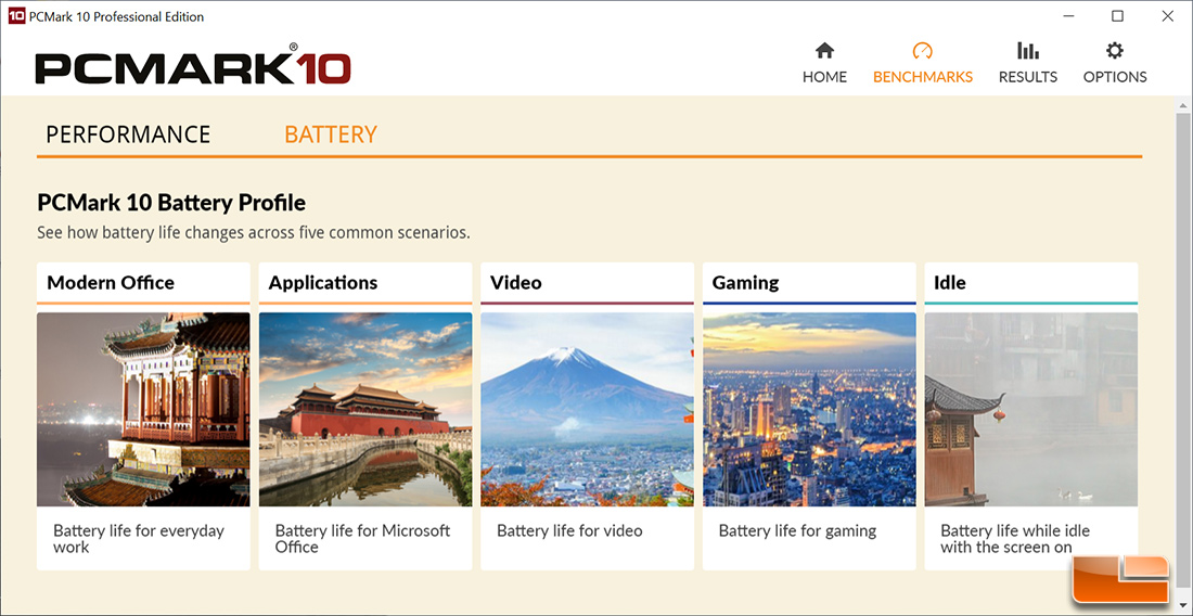

Battery life is one of the most important factors for choosing a laptop. But measuring and comparing battery life is hard because it depends on how you use the device. PCMark 10 was designed to complete benchmark for the modern office and includes a new battery life benchmark that is pretty good.
PCMark 10 Battery Test
There are five battery life tests in PCMark 10, but we opted to run the ‘Modern Office’ test. The ‘Modern Office’ scenario measures battery life for typical work activities such as writing, web browsing, and video conferencing.
