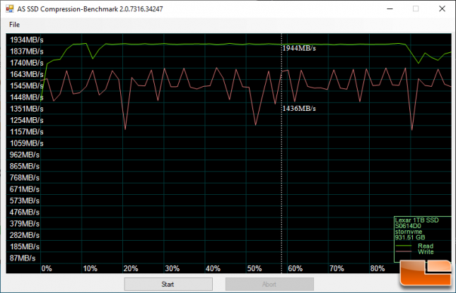

AS SSD Compression:
Benchmark Results: For this benchmark chart you would ideally want to see a straight line as you dont want any compression performance loss as the test goes from 0% compressible to 100% compressible data during the benchmark test period. The compression performance fairly good on the read operation side as you can see it getting better as the compression increases. There were are many dips spotted on the write operation side, with performance hitting around 1.2 GB/s at its low.
