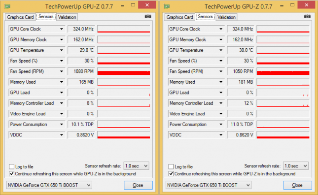

Here are the GPU-Z shots for the NVIDIA GeForce GTX 650 Ti 2GB BOOST reference card that shows one monitor on the left and two monitors on the right. As you can see the NVIDIA GeForce GTX 650 Ti clock speeds, voltage and fan speeds all don’t change when a second monitor is hooked up. The only change is roughly a 5% increase in the memory controller load and about a 1% higher TDP (power consumption) as a result of the higher memory controller load. So, there was a 1C increase in temperature and a 3W increase in power consumption due to this, which is minor compared to the 20W or higher difference seen on comparable cards from AMD.
