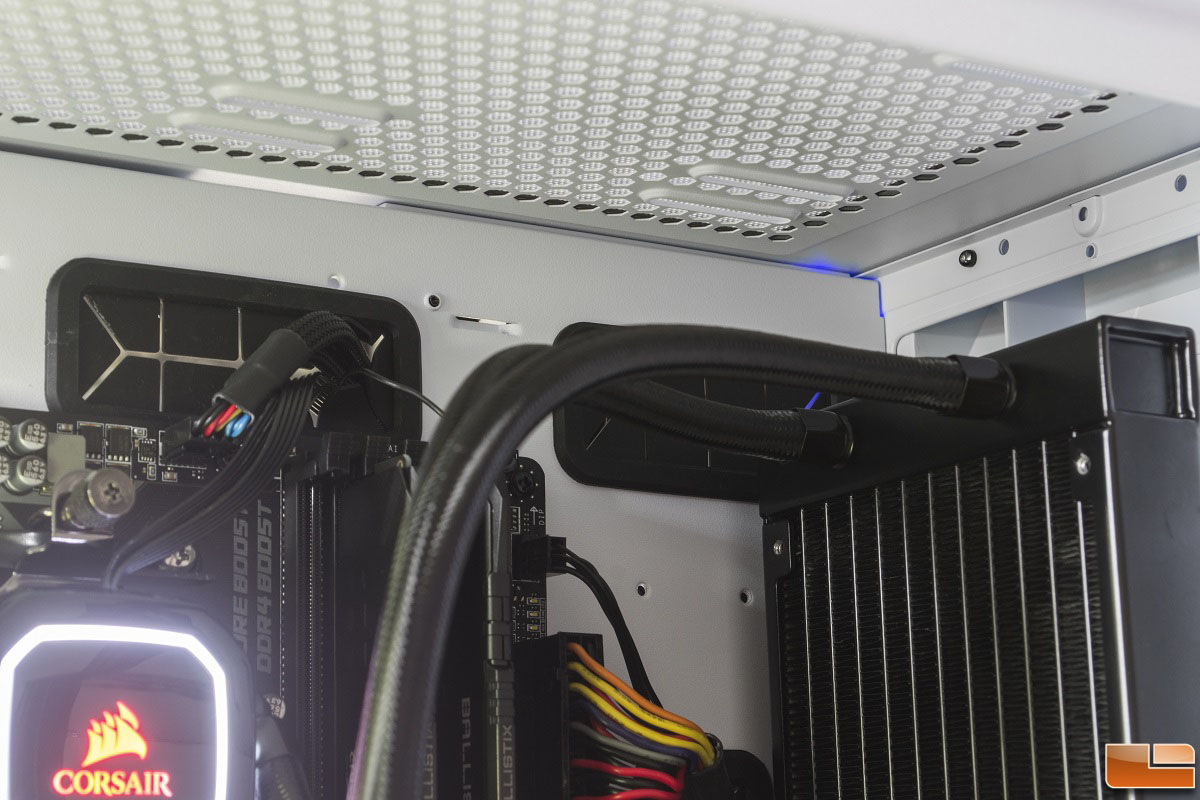

The build process went very smoothly with the Starker. The 360mm radiator to the Corsair iCUE H150i RGB Pro XT and its three fans had no trouble mounting at the front of the case. Because of the tall height of the case, I was able to squeeze the radiator into position without much issue. The cable cutouts on the motherboard tray were also positioned well so the cables could plug into their correct ports. As for the power supply chamber, the cutout is slightly too large for the Corsair CX430M. This left a small amount of empty space behind the PSU to expose a bit of cabling.
As for cable management, I used up quite a few zip ties as the Starker did not come with pre-installed Velcro straps. But even with zip ties, I was able to get the cables nicely managed without too much trouble. The side panel was able to close properly without much pressure put against the cables either.
Taking a closer look at the top cutout of the power supply chamber, there was plenty of room to fit the front radiator and its fans. The radiator and fans were about two inches (50.8 mm) thick together, which meant there was enough clearance for a push/pull configuration. This is because the cutout had a total length of about 3.125 inches (79.4 mm). Of course, achieving a push/pull configuration with a 360mm radiator will require the removal of the HDD tray in the power supply chamber.
Even with a front radiator, there was enough room to clear the HDD tray in the power supply chamber. If the PSU was longer in size, the cables may have had a tight squeeze but it would have been still manageable. But because this build did not utilize the HDD cage, it would have been fine to remove it from the system and keep what was only necessary.
With the 360mm radiator at the front, there was about two inches of clearance from the top of the case. It may have been possible to mount another radiator with fans at the top. The fit may have been very tight, but even with a 280mm radiator at the front, there would be more than enough clearance at the top to fit a radiator with fans.
