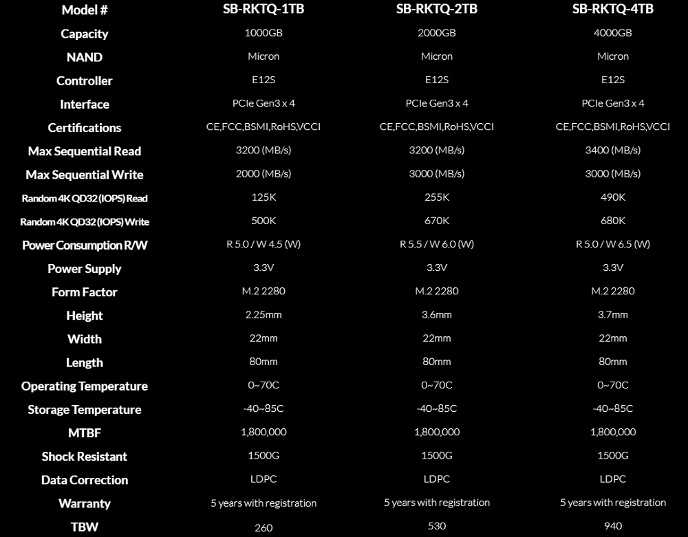

Sabrent is using the Phison E12S controller paired with Micron 3D QLC NAND Flash memory on the Rocket Q SSD series. On their website they mention that the Rocket Q uses the Sabrent RKT 303 controller, but that is just some fancy marketing talk for what is really the Phison E12S controller. Performance on each of the three Rocket Q drives varies greatly depending on what capacity drive that you are purchasing. Right now the Sabrent Rocket Q is being offered in three different sizes; 1TB ($109.99), 2TB ($219.99) and a 4TB model that has yet to come to market. The sequential performance of the 1TB model is 3,200 MB/s read and 2,000 MB/s write with Random 4K performance of up to 125,000 IOPS Read and 500,000 IOPS Write. Moving up to the 2TB model you’ll find the sequential performance increase up to 3,200 MB/s read and 3,000 MB/s write with Random 4K performance of up to 255,000 IOPS Read and 675,000 IOPS Write. So, not only do you double your storage space when moving up to the next capacity, but you’ll also receive better performance in some areas.
We’ve included the general performance numbers from the Sabrent website below, so you can see the different power and performance numbers for each drive capacity.

- SB-RKTQ-1TB – 260 TBW
- SB-RKTQ-2TB – 530 TBW
- SB-RKTQ-4TB – 940 TBW
So, you are looking at 260 TBW for the Sabrent Rocket Q 1TB model and that comes out to being about 142 GB of drive writes per day over the course of five years. That seems like a decent number of writes, but the Sabrent Rocket 1TB drive (TLC NAND Flash) has an endurance rating of 1,665 TBW. That means the Sabrent Rocket 1TB drive has an endurance rating that is 6.4x larger! The endurance rating is one of the key differences between the QLC based drives coming to market and those that are running TLC NAND Flash.
