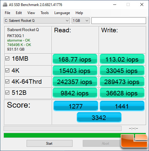

AS-SSD (2.0.6821.41776) Benchmark:
We have been running the AS-SSD Benchmark app for over some time now and found that it gives a broad result set. The programmer has worked very hard on this software and continues to make updates often so if you use it, show him some love and send him a donation. There are now three tests that are found within the tool and we’ll show the results from all three of them.
AS SSD:
Benchmark Results: On AS SSD Benchmark, the Sabrent Rocket Q 1TB drive had an overall score of 3,342 points with sequential read speeds of 2,700.33 MB/s read and 1,808.29 MB/s write. The 4K random results were at 60.17 MB/s read and 129.08 MB/s write.
AS SSD Compression:
Benchmark Results: For this benchmark chart you would ideally want to see a straight line as you dont want any compression performance loss as the test goes from 0% compressible to 100% compressible data during the benchmark test period. The compression performance fairly good on the read operation side as you can see it getting better as the compression increases. There were a few dips spotted on the write operation side, but performance did not drop below 1 GB/s.
