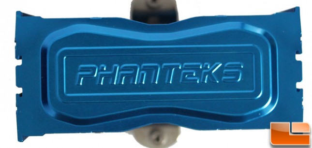

TC12DX Cooler Top
I like the design of the top, the ends of the heatpipes aren’t visible so it doesn’t have an “unfinished” feel. Phanteks has put their name on the top of the cooler, which will be visible once it is installed. Depending on the orientation you install it, their name might look a little odd.

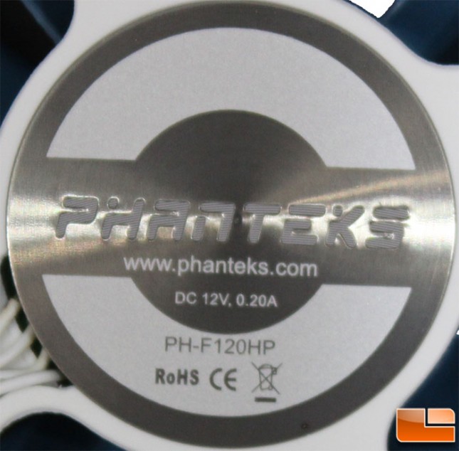

TC12DX Fan Label
On the other side of the fans is a label which provides the model number and a little additional information. These fans are the PH-F120HP, which are rated for a maximum of 1800RPM with a noise level of 27.6dBA, this should make them fairly quiet and efficient.
