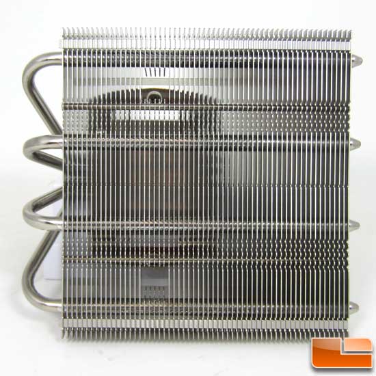

Pulling the fans off we can get a good look at the NH-L12. The overall height without the top 120mm fan is 66mm or 2.5 inches, roughly the same height as a stock Intel box cooler shipped with retail CPUs. The cooler is a lay down style, so the fans blow down on the CPU socket rather than front to back.
At the widest point the NH-L12 has 43mm or 1.7 inches of clearance to the bottom of the cooling fins. This is only in the area where the 92mm fan is not residing. There is room for RAM slots to be cleared as I will show in the installation section later.
Since the base and mounting screws are under the cooling fins there are small sections of the fins removed above the mounting screws. This allows for access to the mounting screws with the provided screw driver.

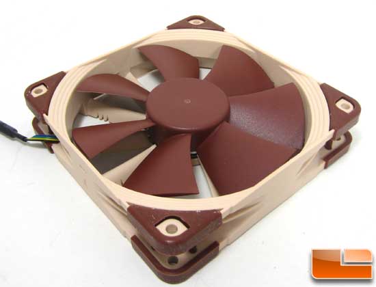

The top fan is the NF-F12 120mm PWM fan. It operates at 300-1600RPM pushing a max of 64.9CMF at 22.4dBA. With the Low Noise Adaptor installed it runs at 300-1300 RPM pushing a max of 43.7CFM at 18.6 dBA. You can read more about the Nf-F12 in our review.
