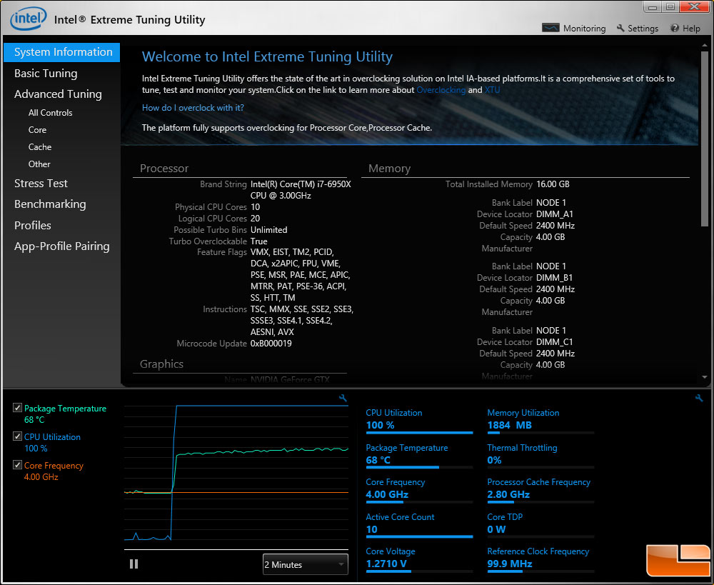

overclock-xtu
After manually setting the voltage to 1.27V and set all cores to a 40x multiplier for a 4GHz clock speed we were seeing 68C load temps. Sure the temperature was 7C higher for the same test, but that isn’t had considering the Core i7-6950X is running 500MHz faster and has a higher voltage set!
