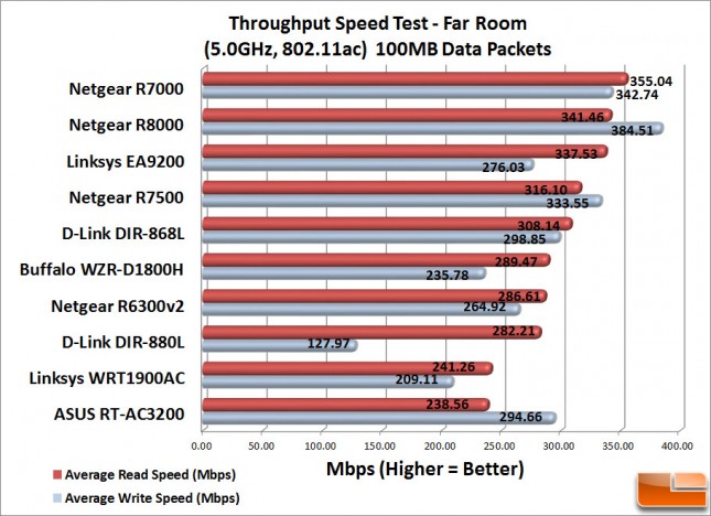

RT-AC3200We then moved our laptop and wireless bridge down stairs to the far corner of the house. The run was more than 40 feet across and through a carpeted floor. We again ran LAN Speed Test (LST) with data packet sizes of 1MB and 100MB. LST again gave us measurements of Average Read and Write speeds which are plotted below.

RT-AC3200_FarRoom_100MB
Benchmark Results: The ASUS RT-AC3200 went from having impressive 1MB data packet throughput test results to being at the bottom of the performance chart when it came to larger 100MB data packets. Clearly, there is an issue here with the great disparity between packet sizes. We were scratching our head at this point, and re-ran out test a number of times to confirm these results.
