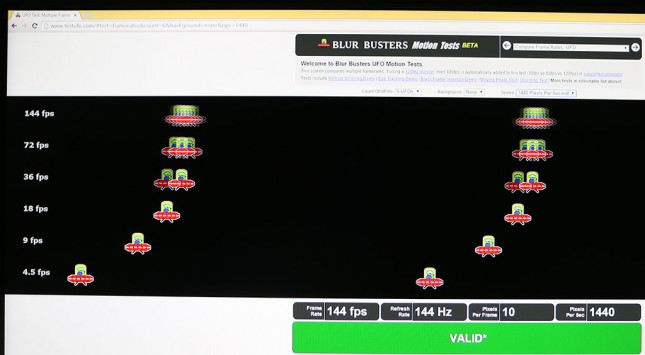

One of the first none gaming tests that we did on the ASUS MG279Q gaming monitor was the UFO test by blur busters that is excellent at showing motion blur. This website allows you to compare up to six different framerates at the same time and you can do it with various monitor modes. This is also a quick test to verify everything is running properly at 144Hz!
blurbusters-ufotest
The ASUS MG279Q ran the test superbly and gave us a valid result!

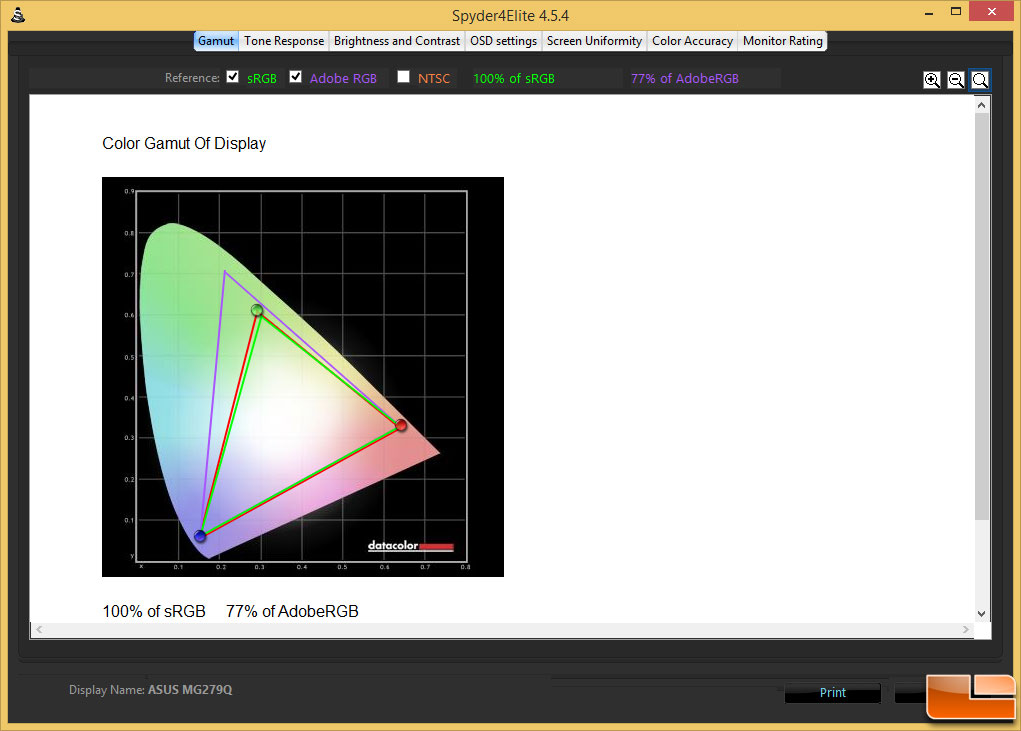

mg279q gamut
Our Spyder4Elite 4.54 colorimeter test results for the color gamut test showed that we had 100% of SRGB and 77% of AdobeRGB coverage.

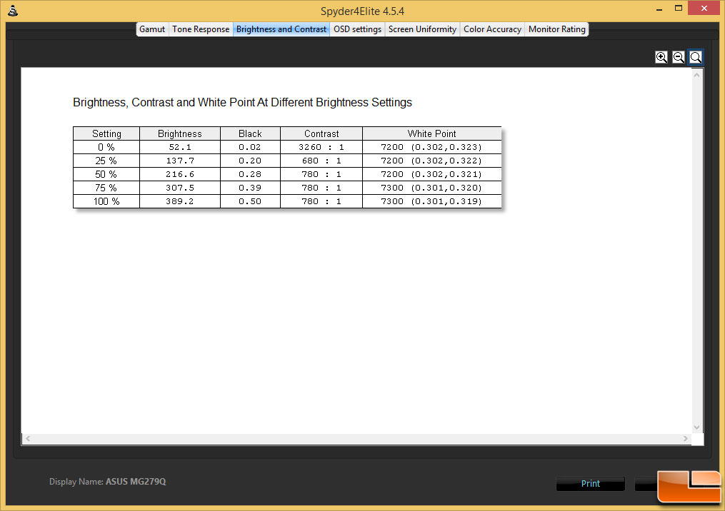

ASUS MG279Q Brightness
The Brightness and Contrast test results showed the display had a brightness of 389 nits and a contrast ratio of 780:1, which is an excellent result. At 100% brightness the black point was 0.50.

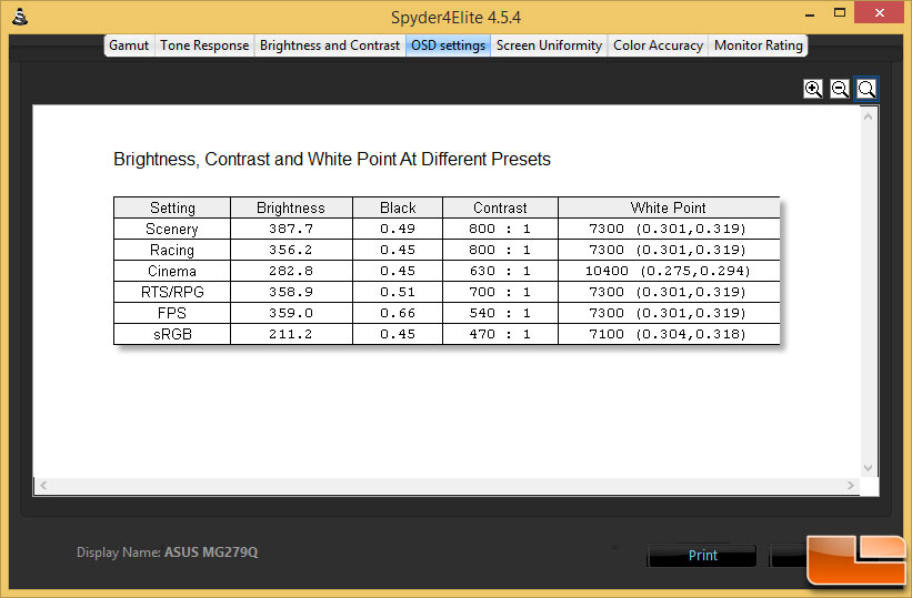

osd-settings
Here is a look at all of the monitors OSD presets to give you a general idea what they do. As you can see from the table above the sRGB OSD preset is the dimmest with the Scenery OSD preset being the brightest.

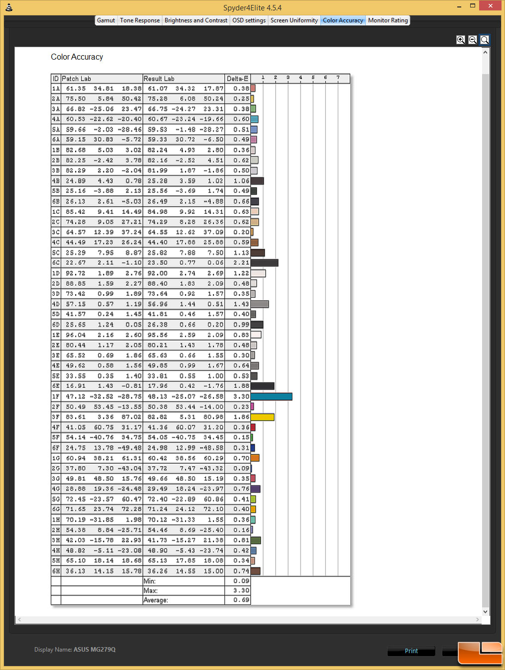

color-accuracy
When testing the color accuracy of 48 different colors we can an average result of 0.69, which is solid result.

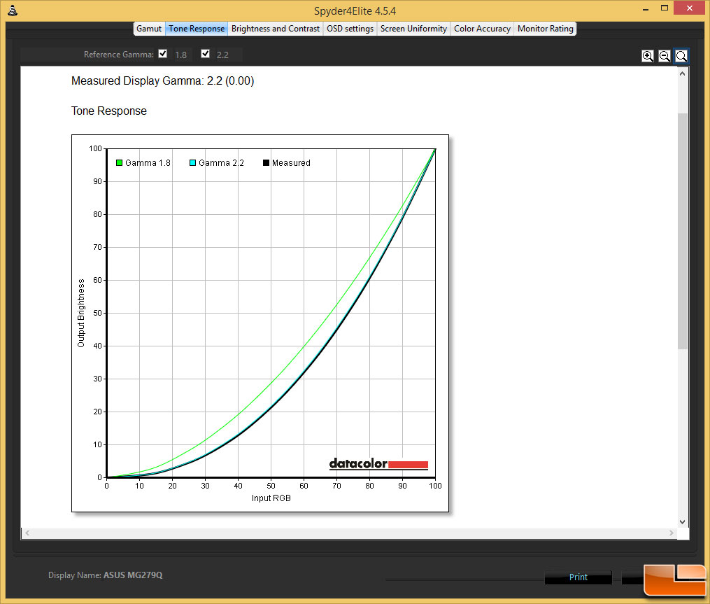

tone-response
The tone response measured at a Gama Level of 2.2 exactly.

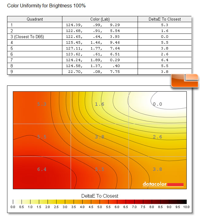

uniform-bright
When running the advanced Color Uniformity test with the brightness of the display at 100% we see some variance on the display, mainly in the lower left hand corner.

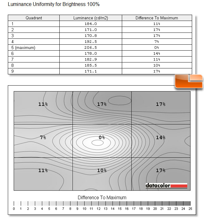

uniform-luminance
Here is a quick look at the luminance uniformity test that was conducted in the middle of nine sections on the gaming display. The brightest part of the display is the middle, which is common on most any display with one of the corners being the darkest. Some of the outside sectors were found to be up to 17% darker than the center of the display.

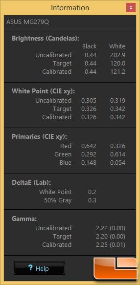

mg279q-info
Here is a look at the View Info menu that details Brightness, White Point, Primaries, DeltaE, and Gamma measurements both before and after calibration.

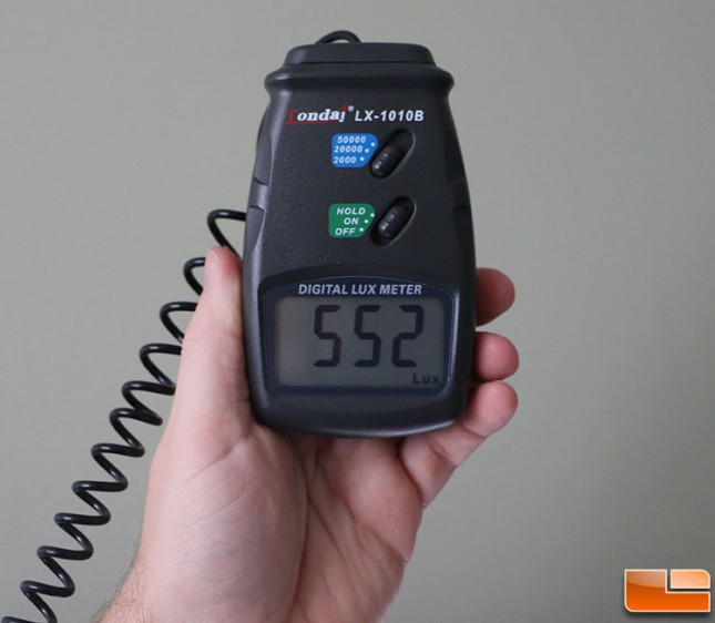

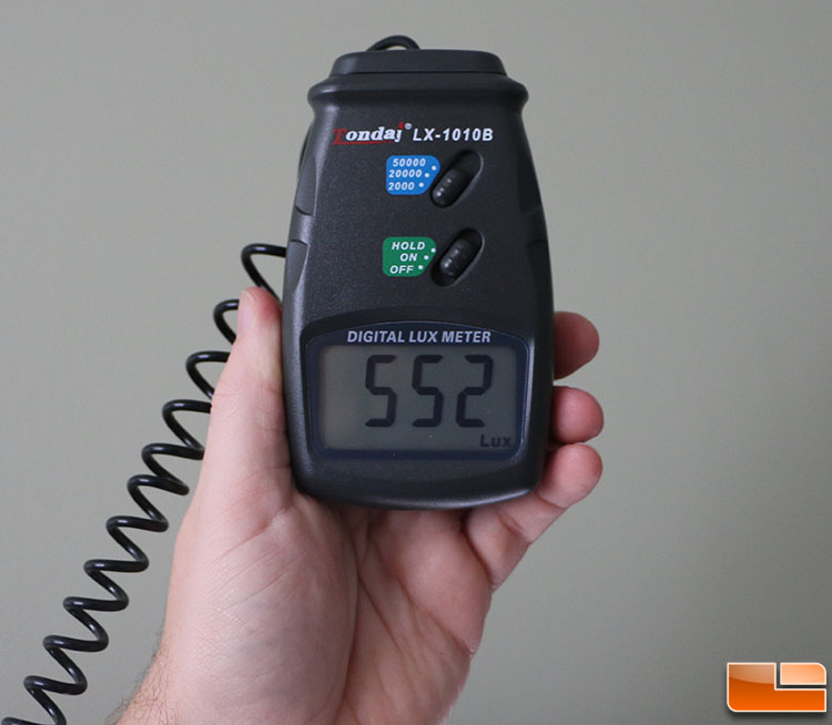

lux
Those that are curious about measured brightness we got a measurement of ~550 lux on our LX-1010B light meter on a white background in the middle of the screen with the brightness set at 100%, which is pretty good.
