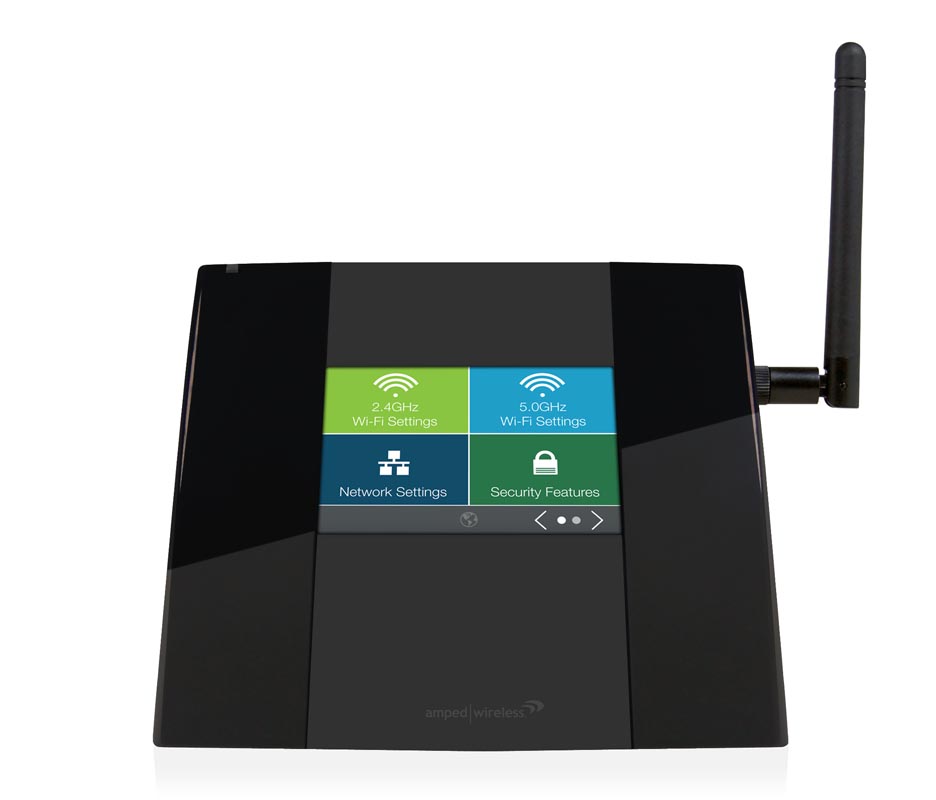

Amped_TAP-R2_main_front_stand
Understanding that the Amped Wireless TAP-R2 is only an AC750 device, comparing against our other Wireless-AC suite of routers might seem a bit unfair. We still would like to get a measure of how well the TAP-R2 performance is when connected to a very fast 802.11ac device.

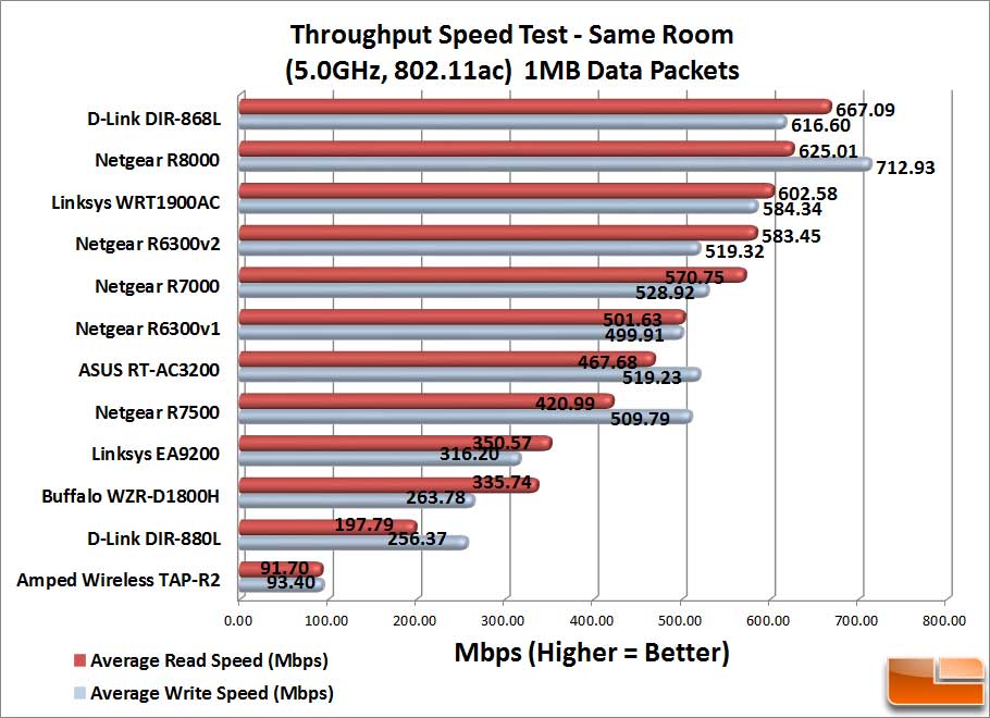

TAP-R2_SameRoom_1MB
Benchmark Results: Looking at the 1MB data in the same room should give us an indication of the maximum throughput our routers can achieve. With an Average Read Speed of 91.7 Mbps and Average Write Speed of 93.40 Mbps, the Amped Wireless TAP-R2 is clearly out matched by our suite of routers using multiple antennas over the 5GHz band.

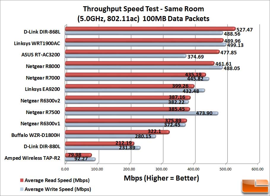

TAP-R2_SameRoom_100MB
Benchmark Results: We look at 100 MB sized data packets because it is a good indicator of what multimedia streaming performance should be. The throughput test results for the Amped Wireless TAP-R2 is consistent with what we saw at 1MB. Average Write Speeds are around 92 Mbps while Average Read Speeds drop slightly to around 80 Mbps.
