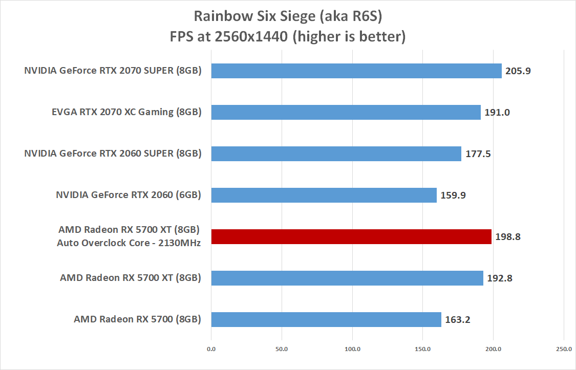

The higher GPU core clock speeds helped gaming performance by about 3% at 1440P in actual game titles like Rainbow Six Siege.
