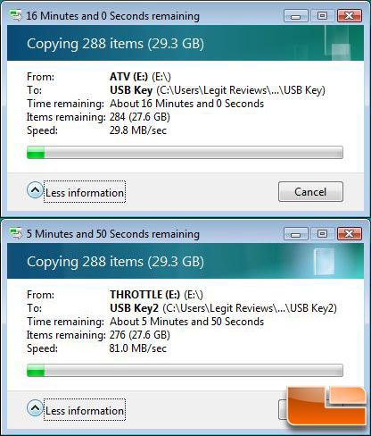

The last test that I did on the 32GB OCZ Throttle eSATA Flash drive was to compare it to the 32GB OCZ ATV USB 2.0 Flash drive doing some file transfer tests on Windows Vista Ultimate 64-bit. For this I loaded up both drives with the some movies and pictures and just did drag and drop tests to and from the desktop.
File Tansfer Test on Windows Vista 64-bit
Benchmark Results: Moving files from the Flash drives to the desktop showed that the Throttle was transferring the files at 81.0 MB/Sec and the ATV was transferring the same files at 29.8 MB/Sec. There is no denying that moving files from an eSATA drive to the desktop is significantly faster than using a USB 2.0 drive.
