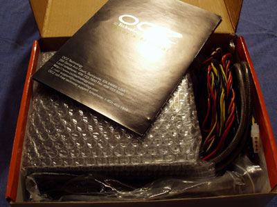

The OCZ PowerStream came in simple but attractive packaging that does its job.
I would not recommend shipping this power supply with out more packaging as
this box is not designed for it. The box has a nice graphic showing the power
supply and it gives a rundown of the basic features and specifications on the
back.
Once open you can clearly see that the power supply is sheathed in bubble wrap.
The box also contains a short manual with installation information and the warranty,
fat lot of good that will do me. Once the contents are spread out you can see
the normal assortment of power supply items, four mounting case screws, zip
ties, power cord, and a package of silica gel beads. OCZ also ships a 24pin
to 20pin adapter for people who do not have server or BTX motherboards, which
is most of us.
