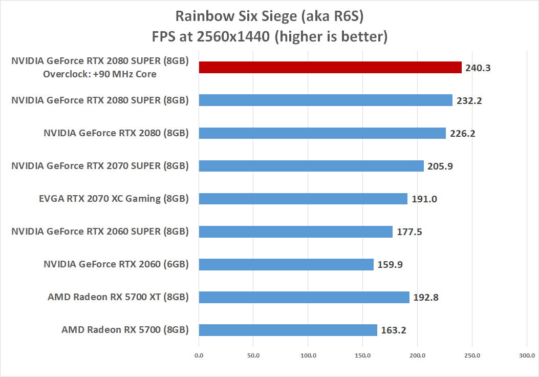

Rainbow Six Siege showed a 3.5% performance boost at 1440P with the overclock!
