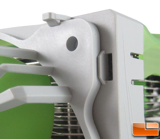

Each fan is attached to a mount that clips to the cooling fins. The fans are removable to aid in the installation process.
You can remove the whole mount or just the fan.
