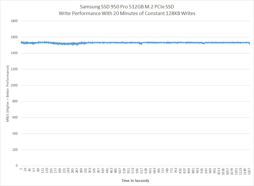

Samsung says that proper airflow is recommended for the Samsung SSD 950 Pro to keep the drive operating under it’s 70C threshold. Samsung has implemented something called Dynamic Thermal Guard in the firmware for the SSD Pro 950 to keep the drives performance from dropping due to thermal throttling. Our solution was to place a 120mm cooling fan over the Samsung SM951 M.2 PCIe SSD to help keep it cool. The exact fan we used was the Noctua NF-S12B-FLX, which spins at 1200RPM for 59CFM of blowing power.
throttle
With this setup we found no significant thermal throttling when we performed over 20 minutes of constant 128KB writes to the drive. The drive started out at around 1640 MB/s and settled down to around 1520 MB/s for the entire period of time. Samsung did not go into great depth about how Dynamic Thermal Guard actually works, but here is the information they gave to the media ahead of the SSD 950 Pro launch.

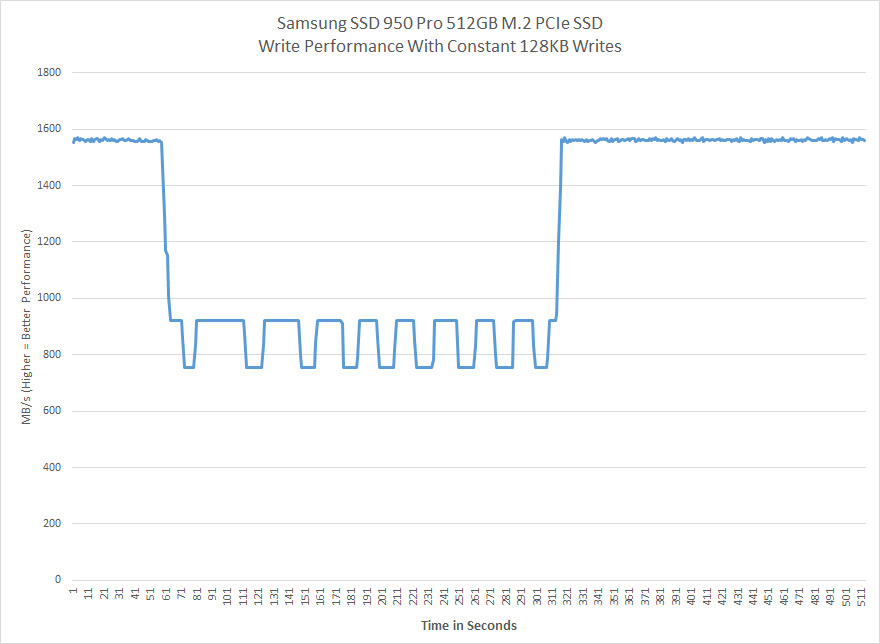

When we let everything cool back down and re-did the test without the 120mm fan we noticed that the drive started to throttle at the 62 second mark. Our performance went from being ~1560 MB/s all they way down to 753 MB/s and then rising up to 879 MB/s during the throttle period. We plugged the fan back in at the 310 second mark and performance went right back up to ~1560 MB/s like nothing ever happened.
