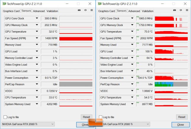

NVIDIA GeForce RTX 2080 Ti FE Temperatures:
The NVIDIA GeForce RTX 2080 Ti uses dual fans that always runs, so we were seeing 32C at idle and 75C at load while gaming for an extended period of time. The fan was spinning at 1500RPM at idle and got up to 2000RPM at load. Noise levels were acceptable and it shouldn’t be heard too much inside a case with good airflow even while gaming. The GeForce RTX 2080 ran slightly cooler.
