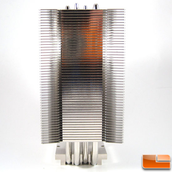

Enermax ETS-T40-TA CPU Cooler front
The Enermax ETS-T40 has four U shaped heatpipes and 52 cooling fins. The ETS-T40-TA we have has nickel plated heatpipes. The ETS-T40-VD and ETS-T40-TB come with an anti-oxidization coating on the heatpipes.

Enermax ETS-T40-TA CPU Cooler side
The closed section of the side and the corners of the fins themselves create what Enermax is calling Vacuum Effect Flow. As air is pushed into the heatsink by the fan, the fins create an air channel which results in additional air being sucked in.

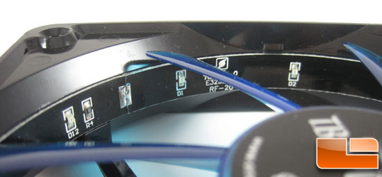

Enermax ETS-T40-TA CPU Cooler fan led
Now most LED fans have a couple of large LEDs in the corner of the fan body. The fan for the ETS-T40-TA has a whole slew of them around the inner rim of the fan body. With this many LEDs, this fan is going to be bright.
