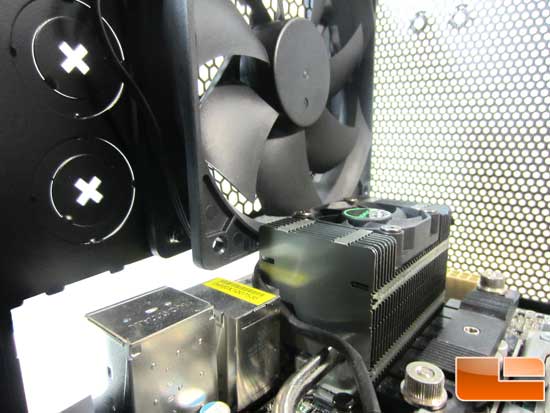

When I first got the 300R and looked at the box I had high hopes; it looked like the little case had some real potential looking at the box. As I started to assemble my system into it I started to run into some issues. The first was interference with the rear exhaust fan and then my motherboard.
Corsair Carbide 300R clearing rear fan
When I went to install my ASRock X58 Extreme 3 ATX motherboard in the Corsair 300R an issue became apparent. This board has a very large heat sink with a fan on it in the middle of the rear I/O panel that is far from common. It would not fit under the fan that comes pre-installed on the back of the Corsair 300R. This is the first case I have put this board in where this has come up, but not all motherboards have tall heat sinks on it like mine does so I cant really fault Corsair on this. So, if you happen to have a mainboard with a large heat sink sticking up taller than the I/O ports, then the rear 120mm fan could be an issue. This issue is pretty minor, though, as you can just move the fan or get creative and mount it on the outside of the case.
