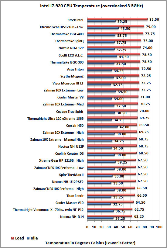

Now with the system overclocked to 3.5GHz the heat is turned up. At full load the ECO A.L.C. cooled our i7-920 at 73.50*C. Now that is 10*C cooler than the stock Intel HSF and 11.25 degrees warmer than the current $90 air king, the Noctua NH-D14. The Corsair H50 is still holding its 4 degree lead.

Now, the coolers like the Corsair H50 the ECO A.L.C. support dual fans for a push pull scenario. Since I tested the H50 with dual fans I felt I needed to treat the ECO A.L.C. the same. So I fired up the ECO with a pair of NH-U12P 120mm fans. Running the system at 3.5GHz the dual fan configuration helps. The temps dropped 4 degrees to 69.5*C at full load, putting it in line with the performance of the stock Corsair H50. As you can see from the chart, the airflow direction of blowing into the case or exhausting out didnt make any difference. Running a higher CFM fan could help due to the ECO A.L.C. radiator design, but I cant test that theory as I dont have any.
