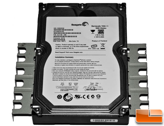

Hard drives, floppy drives or other I/O panel devices not 5.25 wide must utilize the rails and screws provided to be installed. Id much prefer to see a more tool free design on these but with a budget case some concessions must be made.
AeroCool Vx-E - HDD With Rails Mounted

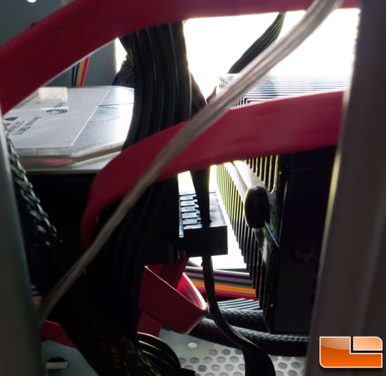

Also, theres no room to route cables behind the motherboard tray so cable management gets to be a nightmare quickly — especially for those without modular PSUs. Its possible to squeeze a USB cable back there but its tight and Id be afraid of breaking something. I have three hard drives, two SSDs, two optical drives, and a fan controller and all of this was frankly too much to try to fit into the case.
AeroCool Vx-E - A Mess of Cables
While physically possible, the cable management was just too much of an issue and I didnt attempt to fit everything in. With that said, this is a lot of hardware and likely more than many buying a budget case would possess, so those with more modest array of hardware should find enough space to meet their needs. Lastly, my Noctua NH-U12P SE1366 cooler barely had enough clearance for the left panel to fit on but thanks to the mesh screen which bulges out slightly, it fit just fine. If you have anything taller than this, it may be a problem so its something to keep in mind.
