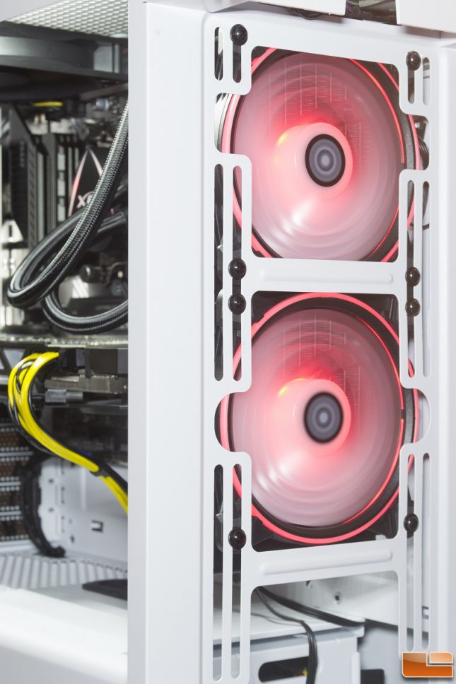

Installation was very straight forward. It was very easy to mount the water block onto the Ryzen 9 3900X CPU with the provided accessories. The tubes were also very flexible and did not show signs of kinking in tight angles. Because of the extra cables for the RGB components, I took extra time and effort to manage those cables. Once everything was installed and tidied up, it was time for some testing.

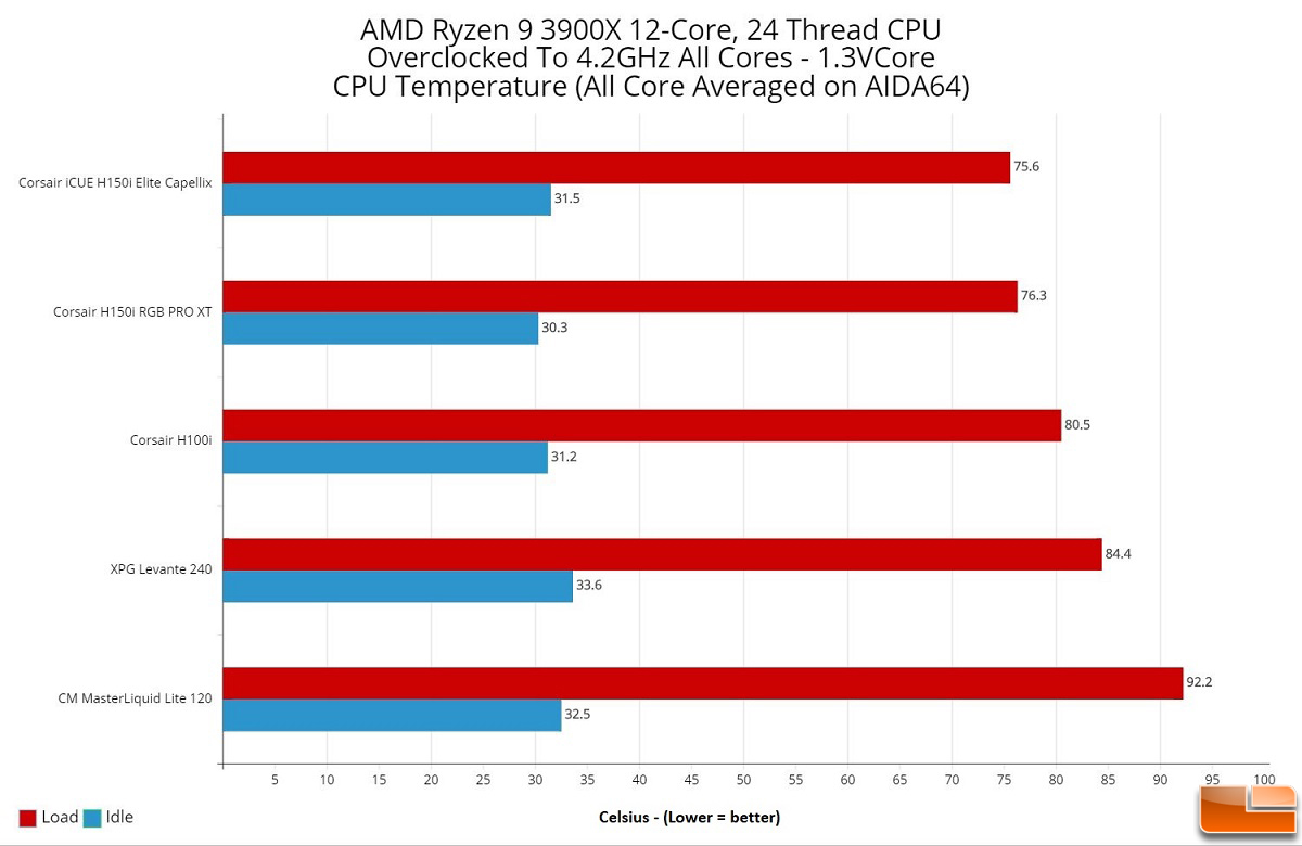

As for the testing methodology, the AMD Ryzen 9 3900X was overclocked to 4.2GHz on all cores. Voltage setting was set to 1.3v with the radiator mounted at the front of the case. The case of choice was the Corsair iCUE 4000X RGB with the side and front panels closed off. There were three Corsair SP RGB ELITE 120mm fans for exhaust: one in the rear, and two at the top. This was to simulate a real-world scenario on how the cooler will perform in a typical gaming setup. Results may vary depending on the computer case and fan configurations.
The fans were attached directly to the MSI Bazooka B550M motherboard. The fan settings on the motherboard were set to run all fans in the case at 100% when the CPU temperature reaches 60C, but lowers fan RPM to 25% during idle. Ambient room temperature was 20.5C with AIDA64 running a 20-minute stress test on the CPU, FPU, and cache for maximum heat. Idle tests will also consist of a 20-minute run period sitting on the desktop. Lets take a look at the benchmark results below.
The performance of the Levante 240 was as expected. With an average fan speed of 2193 RPM at load, the load temperatures averaged out at 84.4C after the 20-minute stress test. Compared to the Corsair H100i, the Levante 240 ran much quieter but at the cost of performance. The SP120 fans on the H100i was significantly louder at 2803 RPM averaged, which correlates to cooler temperatures overall.
Idle temperature on the Levante 240 was also warmer than the rest of the coolers in this test at 33.6C. This was because the fans ran at a speed of 646 RPM averaged. It was warmer than the 120mm Cooler Master MasterLiquid Lite 120, but that was because it had an average fan speed of 931 RPM.

In terms of appearance, the only thing I would improve is the light diffusion on the pump head. It is easy to pinpoint where the LEDs are. At this price range, it makes sense to have better RGB illumination. But as for the fans, the rings and fan blades diffuse the light very evenly.
