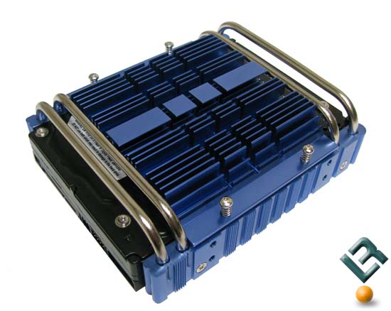

The hard drive I will be using to test the cooler is a Western Digital Caviar WD2500 250GB SATA hard drive. Temperatures were taken using a drive utility called Active Smart 2.26 which utilizes the S.M.A.R.T. technology in the drive. To test the drive, I left the system set idle for 1 hour, and then copied 30GB of data to the drive to get it heated up. This was done with the drive in 3 configurations:
- Bare drive in the case drive cage without any cooling.
- Bare drive with a 120mm case fan installed on the drive cage.
- With Aluminum drive cooler and installed into the 5.25 bay. Note: all the bay covers installed after the above image was taken.

First, we will look at the idle temperatures. As one would expect the bare drive was the hottest. What got my attention was that Ultras Aluminum cooler cooled better then the fan configuration. The Ultra cooler kept the drive at 5C (8F) over room temp compared to the active cooling from the fan, which kept the drive a 7C (12F) over room temp.
Next, we have the load temps. Again, Ultras Aluminum cooler wins. The bare drive and fan configurations both increased by 7C (12F) over their idle temps. The Ultra cooler however only increased by 2C (4F).
