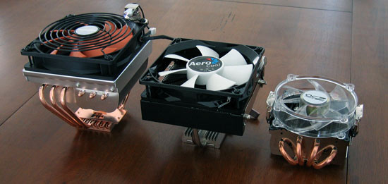

The Thermaltake Big Typhoon VX dwarfs the Aerocool Xfire and makes the OCZ Tempest look like nothing more than a paper weight. The fan that Thermaltake uses with the Big Typhoon VX moves 86.5 CFM of air at 2000 +/- 10% RPM at just 24dBA. The nice thing about using a variable speed 120mm fan is that the speed can be reduced to 1200 RPM’s resulting in a noise level of just 16dBA at idle. The noise level of the fan was unable to be detected by our audio test equipment as the rest of the test system and ambient noise levels were louder than the fan when running at full speed.
