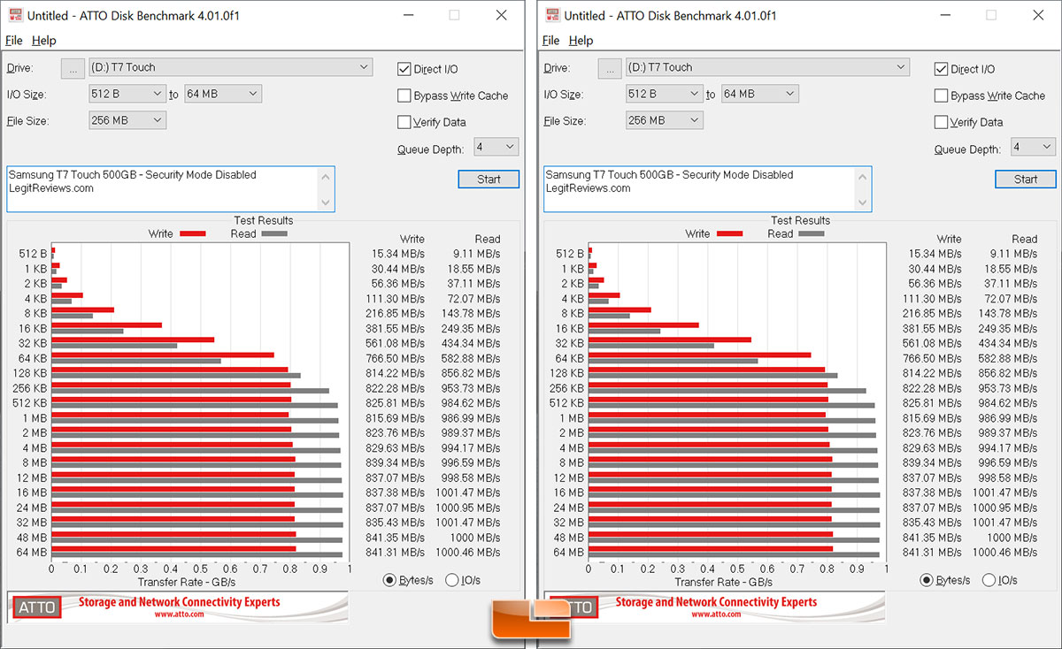

Samsung T7 Touch Portable SSD - ATTO Disk Benchmark
Next up we ran ATTO Disk Benchmark 4.01 and reached top speeds of 1,001 MB/s read and 841 MB/s write at QD4.
