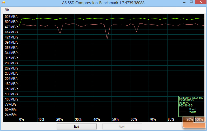

Samsung 850 Pro 1TB AS-SSD
Benchmark Results: The graph proves out that the performance isn’t predicated on data compression as there’s no slope to the graph lines.
