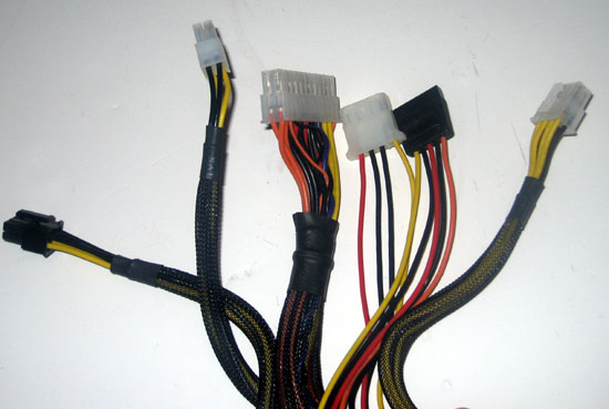

There are quite an assortment of cables for use on your system. You have your usual 24, 4 and 8- pin power connectors, as well as two pci-e power connectors. You also have 15 drive connections (6 SATA, 8 Molex and 1 mini). This should be plenty for almost every user.
pc power silencer 750
