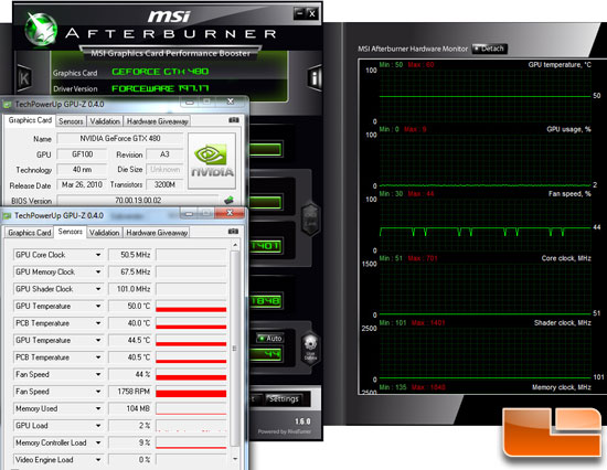

With one monitor installed the GeForce GTX 480 would idle at 50C on the new BIOS. This is a 7C drop from the very first time we ran the idle test and is thanks to the corrected version of GPU-Z and BIOS improvements.

| GTX 480 1 LCD | GTX 480 2 LCD | GTX 480 2 LCD | |
| vBios | 70.00.19.00.02 | 70.00.18.00.01 | 70.00.19.00.02 |
| Core Clock | 50.0MHz | 405MHz | 405MHz |
| Mem Clock | 67.5MHz | 924MHz | 924MHz |
| Shader Clock | 101.0MHz | 810MHz | 810MHz |
| Idle Temp | 50C | 85C | 75C |
| Idle Power | 166W | 235W | 236W |
| Fan Speed | 1758RPM | 1799RPM | 1985RPM |
| Fan Noise | 52 dB | 52 dB | 54 dB |
