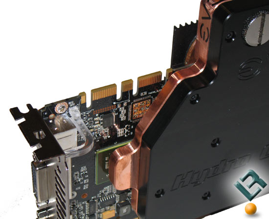

We used a water cooling kit with 3/8″ tubing, so we installed the correct high-flow barbs and blocked off the side that was inconvenient for our test system. Water should flow in the E of EVGA and out the A and direction does matter. Since our card came without the manual, initially we had this reversed and performance slightly improved by just changing the direction of the coolant.

It would be hard to do a review on the EVGA GeForce GTX 280 Hydro Copper 16 without taking things apart. We pulled off the waterblock and should note that our card was a very early prototype and has one of the very first blocks made. The block is made from solid copper and they weight of the block leaves no doubt as to this.
Just for fun, we broke the warranty seal on the block to take a peak inside to see what EVGA was up to and what we found actually shocked us a bit. We were expecting to see thin cooling fins above the GPU and possibly the memory ICs but found something that looked familiar. The water channel inside the waterblock was machined with letter Es that match the E in the famed EVGA logo. The above image shows the retail box and the E compared to the Es inside the water block. This is something most people will never see, but now you can say that youve seen it.
