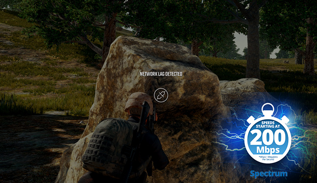

We are based in the St. Louis area and recently got the free internet speed bump to 200 Mbps. Our experience was pretty good until we tried playing the popular online multiplayer battle royale game title called PlayerUnknown’s Battlegrounds (PUBG) on our wired desktop PC. We kept getting complete game freezes while playing and the much-hated network lag detected error would pop-up on the screen. Going from 100 Mbps internet service to 200 Mbps internet service ruined our gaming experience and that makes absolutely no sense.
PUBG Network Lag Detected
After raging and cussing out Charter we did some quick network tests. We figured out that when we directly connected our gaming PC to the cable modem that Charter provided that everything was fine, but once we hooked up our trusty Netgear Nighthawk X6 AC3200 Tri-Band WiFi Router that we have been using for years that our gaming experience went down the toilet. It made little sense to us as we were using a wired connection and this router has been reliable for years. When we ran the Ookla Speedtest when we were directly connected to the ARRIS DOCSIS 3.0 cable modem provided by Charter we were getting around 215 Mbps down, but on the Netgear Nighthawk X6 we couldn’t even reach 165 Mbps. We lost 50 Mbps of performance somewhere on this TCP test, which shows that something isn’t quite right.
