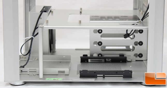

With the front and side panels removed we can see the interior of the case and the beginning of the compartmentalized design of the cube case. The top layer supports the motherboard components and exhaust fan, while the bottom includes the power supply, hard drives, slim-line optical drive and front intake fan. The motherboard tray has the standoffs pre-installed for us, to make installation easy. There are two holes in the tray, one provides access to the back of the CPU for installing coolers, and the other is for the auxiliary power cable. The motherboard tray can be removed by five little screws, three on the back panel, and two on the front corners.

On the right side of the bottom layer is a front intake fan, that pulls air from the side panel and blows it towards the back of the case towards the hard drive cage. At the back of the bottom layer is the hard drive cage that can be removed to install your hard drives. This cage will support three 3.5″ drives and one 2.5″ drive. The 3.5″ drives are protected with anti-vibration washers, and the 2.5″ drive will be installed with similar rubber washers. The front intake fan is the same as the rear exhaust, a Jamicon KF1225S1LSBR. Lian Li has also included an intake filter on the fan, however in order to clean it, you will need to remove the entire fan cover by four tiny screws (two on each side), this is easiest with the fan assembly removed by the two thumbscrews.
Taking a look at the right side of the chassis, we see the slim optical device bay at the front of the chassis, and the power supply location at the back of the chassis. As we saw from the external view, there is an air intake for the power supply in the bottom of the chassis. Lian Li has also installed two stands for the power supply, which includes anti-vibration strips to reduce any noise caused by the power supply fan.
The hard drive cage is held in place with two thumbscrews, and then it slides out of the chassis. The cage will hold three 3.5″ drives and one 2.5″ drive on the top.
