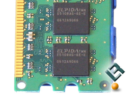

Kingston PC2-6400 IC's
Once the heat spreaders were removed we could read that the Printed Circuit Board (PCB) ID was based off the reference JEDEC design, which is something that Kingston is known to do. While other companies use lower cost PCB’s made by Brain Power Co. Kingston has chosen to go with another source. Kingston informed Legit Reviews that this was done to insure their parts are reliable and perform to JEDEC specifications. After looking at the memory IC’s they were determined to be Elipda IC’s with the part number E5108AG-6E-E. After trying to look up these part numbers on Elpida’s site we were unable to find the part numbers. These are differnt IC’s than what Kingston was using on their standard HyperX DDR2-800 memory line that we reviewed in late 2005. Looking back to the previous article the Kingston HyperX PC2-6400 modules couldn’t even post at 800MHz, so these modules are a huge improvement for Kingston.
