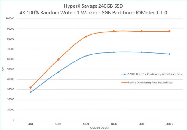

One thing that we did notice is that Kingston runs IOMeter without pre-conditioning their drives to get the speeds they use for the specifications. We pre-condition all of our drives by using a 128KB, aligned, sequential write workload across the entire drive. Prefilling a drive before testing is considered standard practice in the industry and for some reason the HyperX Savage performs very strangely when the drive is prefilled as you can see in the chart above. We went from having 88,000 IOPS, which is close to the drives rated 4K Random Write IOPS (93,000) to some of the lowest IOPS (2,800) that we have ever seen on an SSD for 4KB performance.

Here is how 4KB Random Writes look on a drive that has been pre-filled after running secure erase and one that has had nothing done to it at various queue depths. The HyperX Savage SSD will more closely resemble the performance of the blue line that was pre-filled with data than the orange line with no writes done to it in the real world.

We looked to see if this was just a 4KB file size issue, but we saw the same exact thing at 16KB, 32KB and 128KB on our random write testing. We sent our full IOMeter logs to Kingston for examination and will update you once we have an answer! Rumor has it that Phison is working on a firmware update that could help fix the issue here. Neither Kingston nor Phison has talked to Legit Reviews about that firmware update though and these drives have been available to purchase for two months.
