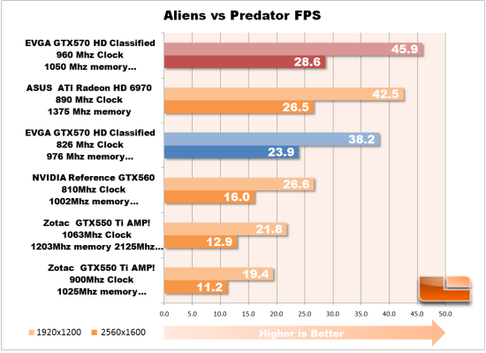

We took the one benchmark that the HD 6970 beat the EVGA GeForce GTX 570 HD Classified and tested again with the overclock only to see the tables quickly turned.
Aliens vs Predator overclock
That extra boost in core and memory added 4.7 FPS at 2560 x 1600 and 7.7 FPS at 1920 x 1200 resolution.
