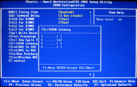

It was not long after I finished my article that we here at Legit Reviews heard from ECS about a bios that would address the issues that we found on the KA3 Extreme board. And it did address these things.

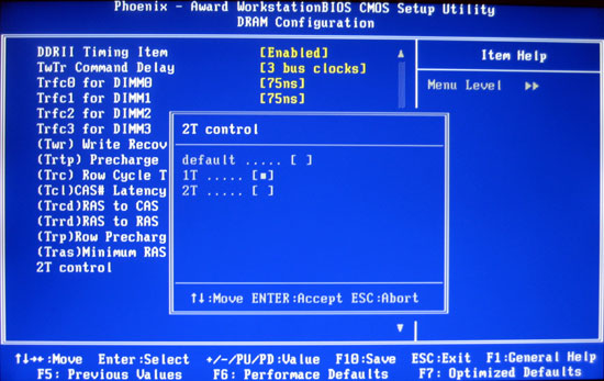

First off, the ram timings that were missing, Cas and command rate, were now present and are working fine. This is great news for those who like to have full control over their systems.
With these settings now available to be manually set, we ran a few of our benchmarks over to give you an idea of how the 4-4-4-12 and 1t timings affected performance.
