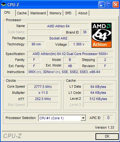

We then switched to a multiplier of 11. With that, and still with the vcore maxed, we were able to reach an HTT of 252.
ecs ka3mvp overclock
