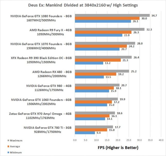

Deus Ex: Mankind Divided Benchmarked – 4K
4K or Ultra HD has four times the pixels of the ‘standard’ 1080p display and is considered one of the most demanding widely used gaming resolution.
4K Benchmark Results: The NVIDIA GeForce GTX 1080 8GB FE averaged 30 FPS with high images quality settings at 3840 x 2160 and it just goes to show how demanding this game title is. The minimum frame rate is above 25 FPS, so while this is technically playable it doesn’t really look at that as you have screen tearing and just low overall performance. You’ll need a multi-GPU setup to run Deus Ex: Mankind Divided on a 4K display with respectable performance as double the performance of a GeForce GTX 1080 should give you right at 60 FPS. With custom AIB cards that are factory overclocked you should be able to average at or above 60 FPS with high image quality settings.
