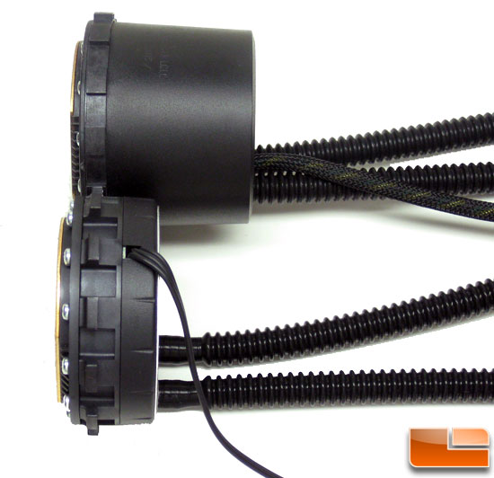

Corsair H70 with the Corsair H50 CPU water cooler
One of the key new features on the Corsair H70 water cooler is the low profile pump/cold-plate unit. Corsair has managed to stuff the water block and pump into a base that is just 1.125″ thick, which is amazing. The old Corsair Hydro H50 had a base that was 2.25″ thick, so Corsair was able to reduce the base thickness by exactly half. Corsair claims that the low-profile pump is high-performance and high-quality. The one negative on the Corsair H70 pump is that the 3-pin power header is not sleeved like on the 3-pin power header on the H50. The good news is that Corsair listened to community feedback and lengthened the power wire from 7″ to 13″ in length. This means that it should be easier to find a power header that is available on your motherboard or that you can route the wire through the back of your case for better wire management where you can connect it to a splitter or another power wire.
